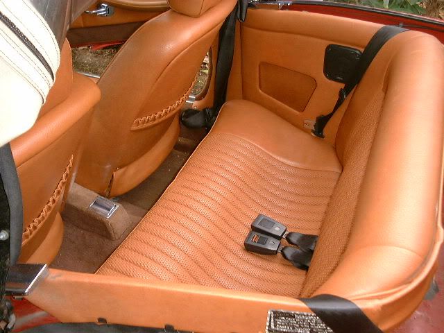

              Mine's saddle tan - as you can see, quite orangey:

                    Hello,
                    This is what the interior of my Stag looks like. Unfortunately the "saddle tan" is peeling off and the darker beige (?) starts to show.

                      I hadn't realised yours was a Mk 1 until I saw the head rests - that being the case, it would never have been Beige (74) from the factory.
                      But who knows, somebody may have retrimmed it :shock:
