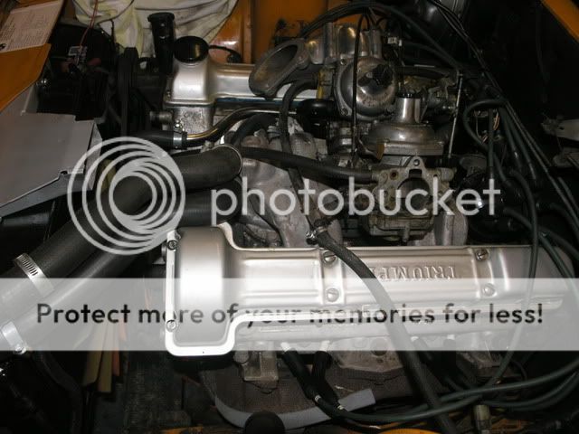

    Quick question though, fitted all new hoses and flushed the rad ( will be doing more flushing tomorrow now I can move the car out of the garage). However when I fitted the top hose if seems to sit on top of the corner of thecam cover now, where the old ones bend allowed it to clear it easily. I know as I could take the covers off with the old one on place but not with this new one. LD supplied all the hoses which other than this one have been a good if not better fit than the previous ones.
    I am tempted to cut thenew one slightly shorter at the thermostat end. But before I get the stanley knife out I thought I would ask if others found this. Iguess it will mean I pull it back slightly the radiator end.
    Hopefully this will show what I mean, old hose placed on top.

    Just shorten it a bit and all will be fine.
    Stuart
      hi i too had same prob with new silcone hoses on cam cover stewart.

          nice engine bay one question, why is the triumph writing upside down on one of your cam covers?
          ben
            As I understand it a few of the early cars had these upside down motifs, as both cam covers were made from the same mould in the early days.
            cheers,
            Peter f
              I have no idea TBH
              Thought it was strange myself! Hadn't really noticed it until I came to refit them and thought I was going barking Cars a 75 but I guess it may have had them changed! Might be to do with them leaking eh? :shock:The RH one at the back is a right b*gger :X
