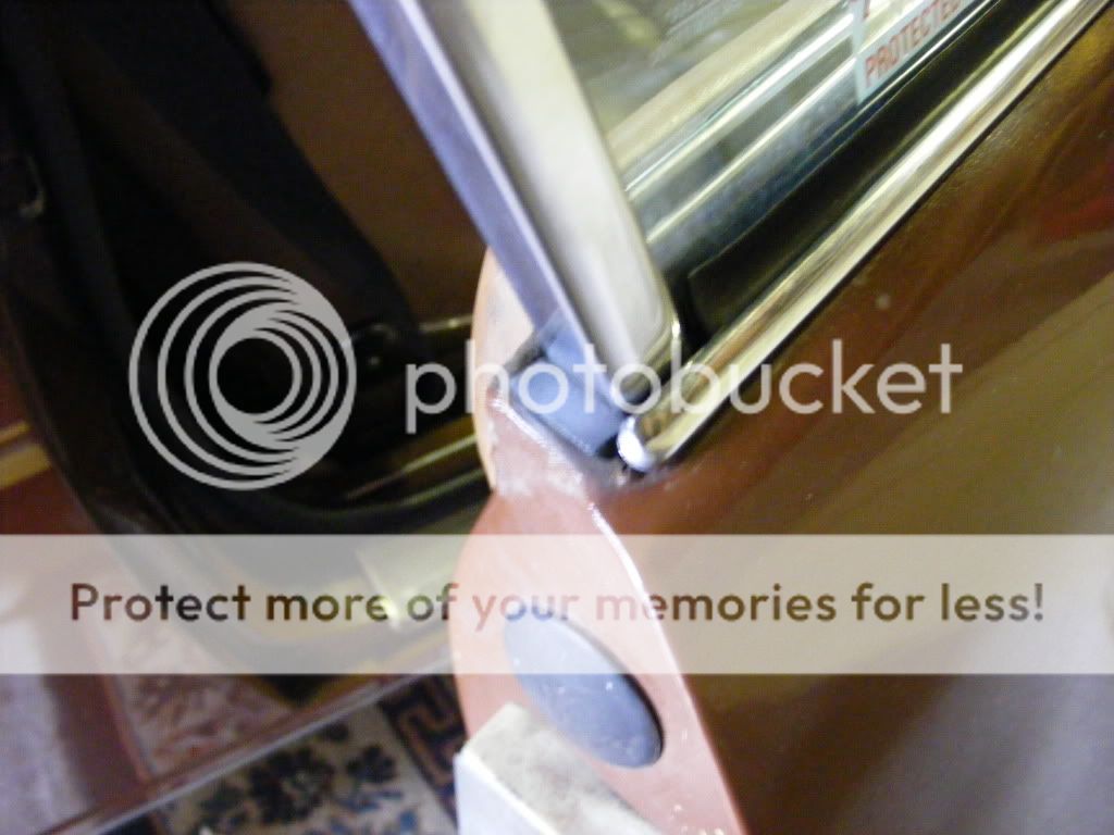

    Now, I've some questions about some small niggling details. Attached is the photo pulled from a previous topic.
    1) With the window frame tightend to the inner skin by the top fixings, the outer 'waist' height seal strip barely touches the glass. Is this common?
    2) The length of above seal, as supplied, overhangs the verticals each side of the glass. Should I cut it back to the width of the glass?
    3) The upper most, or the bit you see of the st.st. profile in which the 'waist' seal strip fits. Should there in turn be something between the profile and door skin?
    4) Should there be a seal between the quarter light frame and the outer door skin?
    5) In the photo. Is that putty or similar sealing the leading edge of the quarter light frame to the door skin? Does it come in red?
    Photos of everyone's window quarter light should answer all the above questions.
    Now quickly, everyone, go and get your camera's!

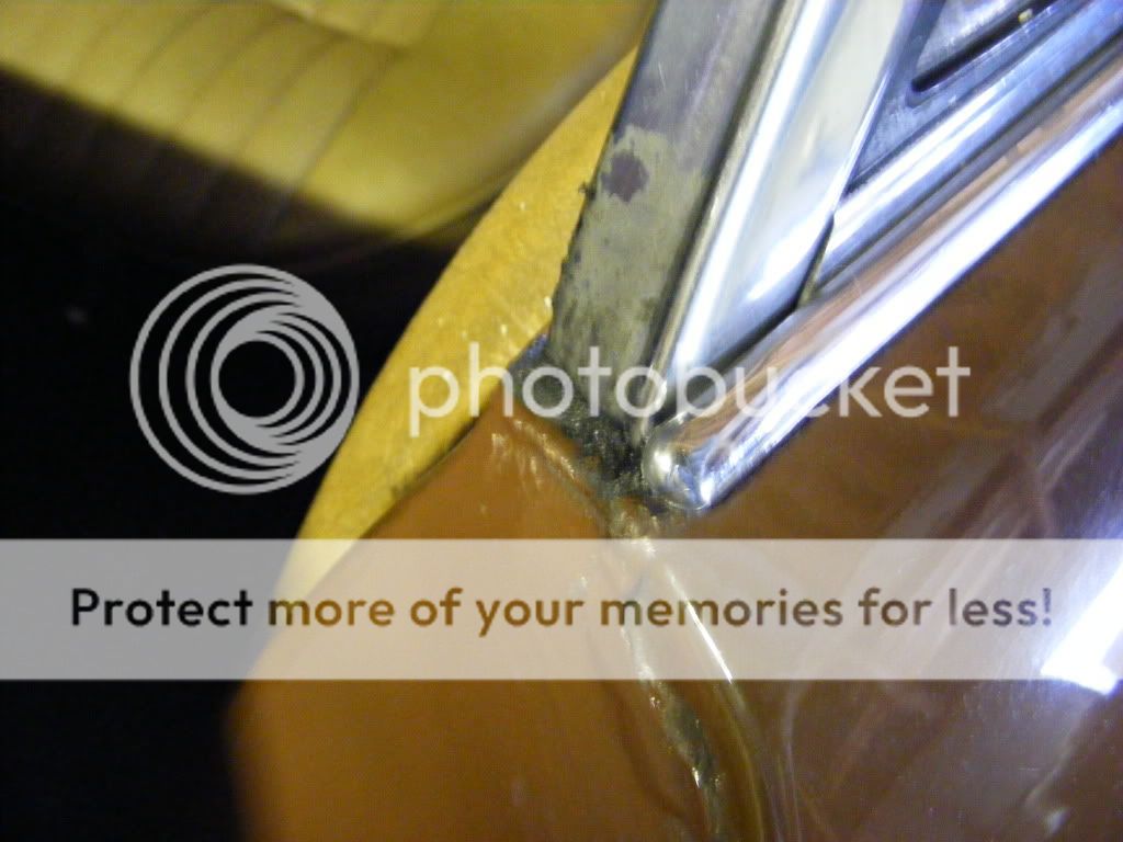

                Hi John
                Picture of thewindow frame and the rubber wedges at the rear of the frame.
                Hope that helps
                Gary

                  Did you source the 'wedge' or was it with the car? I don't see it listed.
                  As for the outer rubber seal, I've fitted the offside window frame now and the rubber on that side makes contact fine, so good it turns inside out and goes down into the door opening when the window is lowered! Any fixes?

                    You can buy a length of tappered rubber from Seals Direct
                    http://www.sealsdirect.co.uk/bbCMS/s...epartmentId=68
                    very good selection of seals, i'd go for the sponge rubber one's.
                    Had the same problem when i fitted mine - i found the best thing to do was to spray silicon onto the seal, just move it away from the window and spray onto the Seal itself .
