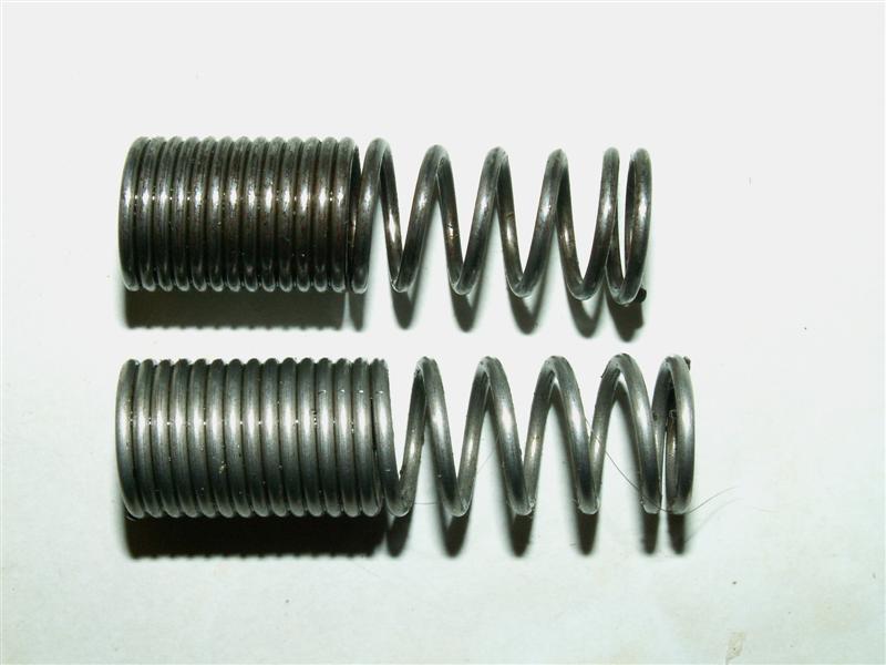

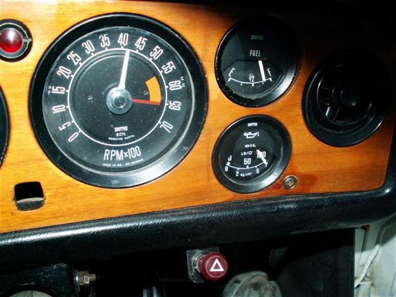

                      In a sense you are correct, it is not working, mine was the same. The problem is the spring is miles too strong. The only plus point it is easy to change it. Just remove the split pin and it should pop out. If it does not then you could do what I did which is place a tray under the engine and crank it over a few times to build up a bit of oil pressure, this will push out the spring and the plunger.
                      The attached picture shows the difference in the springs and also 100 psi at 4000rpm!
                      Roger

                              The thing to note is that Peter at LDparts's engine had done 100,000 miles, in this case the increased pressure will help put off the inevitable rebuild. Mine and Marcus's have fairly new bearings and in my case I had oil leaking from lots of places - past new seals due to the excessive pressure. Also there is no way the valve in my pump opened. the pressure kept increasing with engine revs. i bottled out at 5000rpm when the reading was literally off the scale.
                              Why are you planning to change your pump? - low pressure?If you do change it then simply swap the relief valve springs and the problem is sorted.
