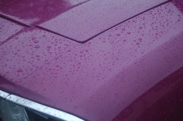

    A few forums I go on have some quite nerdy people who record in great detail how they cleaned their car and what products we use. Not seen anyone on here bore us todeath with all that, but I thought I would show you my progress this weekend in cutting back the Stag's dull paintwork and then polishing it.
    ^^^ The whole of the near-side and the off-side of the bonnet had been done in this one, which was late Saturday afternoon.
    ^^^ The light was going by the time I finished and today it rained so not good for taking pic's other then this detail.

      Your Stag is looking good Ian and its surprising how well you get to know a car after a good clean imo
        Magenta especially comes into its own with a deep shine,looking good Ian.

          You do get to know a car cleaning it - and get depressed as you find a little dent or scratch you KNOW wasn't there last week! Mines in cellulose and is looking better in the pics than reality as you can't see the patches of microblistering - that said I am very pleased at how well its come up. I was going to use G3 as Deanoed recommended it but I couldn't find any, so used Tutle Restorer.
