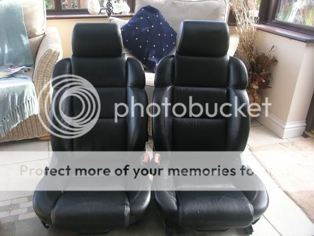

    Since buying the Stag I have been toying with the idea of having the seats (which are totally knackered) either recovered or replaced. I have had a number of quotes on recovering and priced up the diy route via places like Aldridge and so on. But that really does hammer my resto budget, which frankly I would rather spend elsewhere than the soft furnishings
    So left we three alternatives from what I have seen and read about BMW e30sports /Alfa GTV/Fiat Coupe. The BM seats seems to fetch very high prices for black and I didn't want the bother of changing the colours of others. Alfa leaves me with the embroidered badge to sort, and this left Fiat Coupe. So have been on the hunt for the past month or so and managed to pick these up (with unwanted rears although the leather may come in handy?) for £45, plus the costof delivery, although a quick post on Shiply knocked that down to £35 for 120miles and I didn't have to get the car out. So all in I think they are a bargain
    They do have some wear, no tears or holes, but I think it adds to the character. I'll cover them in conditioner and use some leather dye from gliptone in their scuff kit (now ordered)
    So guess what I'll be up to for the next few wet weekends! Although I might tackle the whole interior in one go so need to aquire some more bits over the coming weeks!
    What do you think? (Look away now purists) Cheers Glyn :P

    Welcome to the alternative seats club. I love my tomcat leather seats..
      Great seats. They look nearly as good as my Fiat ones.
        Cheers Richard
        I looked high and low for some Tomcat jobbies.. but the are getting like rocking horse doings!
        It was your post and a couple of others that started me thinking of changing rather than recovering. Although I see the Rover seats fit in the back too you lucky b*gger!

                    Hi Glyn.
                    After 5 years of searching...I finally got hold of a pair of MK1 headrests. Got2 complete seatson fleabay at a snip...Had 2 Mk1's at home got some new diaphrams and foam.....this is what I ended up with........
                      Hi did you get the MK1 headrest recovered before fitting , i have some recovered ready to fit once the seats are redone- but on dry fitting the headrest there is gap between headrest and seat not sure if the may need to be realigned, my request is if you have time for picture square on of the seats with headrest if possible so I can see how they are supposed to line up or if the screws in the back have to be moved down-dont think there is any tolerance for the screws, fit into disignated holes?
                      appreciate picture front on when you can
                      cheers steve
