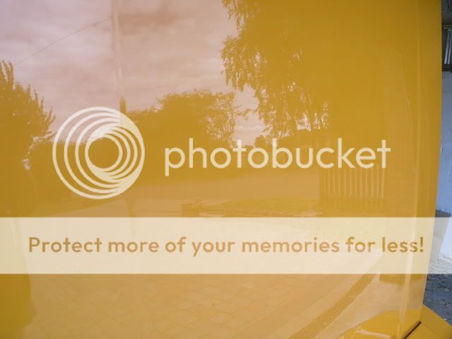

                    Here's the bonnet of my old girl after I spent a day on her, well worthwhile.
                    Topaz does come up lovely :P
