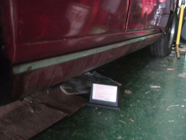

          Heres a picture of just the retaining strip and its location.

              Here's some pics that might help?
              Stuart
                And the rear!
                  And underneath!
                    And underneath again! And yes I will be undersealing at the weekend.
