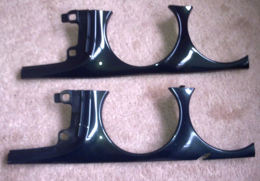

            Well the finish is satisfactory and although the colour doesn't look quite right in this photo, maybe because of the flash or the fact that the old piece of trim isn't clean and polished..
            Once fitted to the car I don't think anyone will notice!

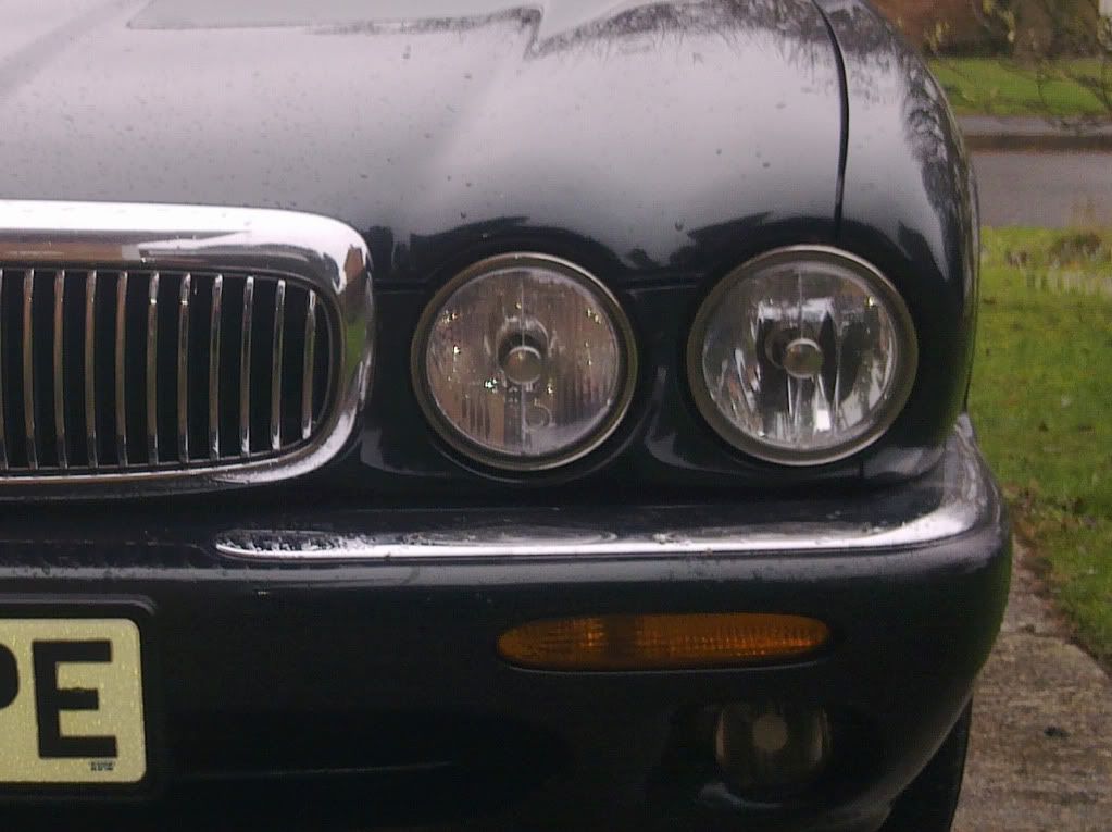

            There's just a small patch on the corner of the bumper that needs attention, it's been painted before by a DPO but looks very flat. It's going to have to wait for the warmer weather.
