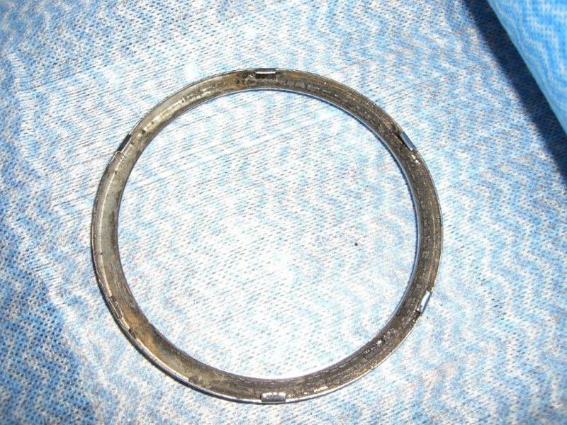

          Hi Guys,
          Finally got around to stripping out the intsruments and cleaning them but when I remove the front bezel I find there is degraded hard black material behind the bezel which is now all crumbly and falling out. I guesse this is old mastic or other used to hold the glass in place. What should I use to replace it? Any help appreciated.

                  I think you will find 2 rings, one on the outside of the gauge, as per the above listing. There is also a ring inside the gauge to cushion the glass which is the one Oz is talking about. Don't know if available, if not a thin carefully applied bead of silicon may substitute.
                    Buy some 1.5mm o-ring rubber like this: http://www.ebay.co.uk/itm/Quality-O-...item1c18ac196f
                    Fit that to the gauge, then fit the glass, then the bezel. You can also use it to make a seal to go between the gauge and the wood, as the rubber ring that was there is probably also 'toast' by now. It is a long time since I did this job, and memory being what it is I can't recall exactly what size o-ring I used as I have bags of different sizes. But 1.5mm seems about right.
                      3mm neoprene for bezel to glass
                      square section o ring for dash to gauge
                      pm me and i will send you some
                      alan
