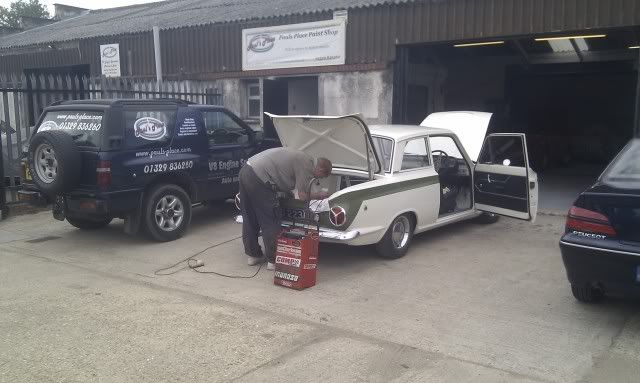

    As you can see, it's not a "flash" garage but there was some interesting stuff there - mainly American as that's Pauls passion. He told me that he has a Camaro (a fixed head version of the red one in the pic's) but had recently sold his "proper" car which was also a Camaro and ran at about 700bhp They also have a body / paint shop and had just done the Lotus Cortina in the pics. I am not a painting expert - but can certainly spot a bad respray - and thought this looked a good quality job. There was a TR6 in there being prepped too. He has rebuilt a couple of Stags in the not too distant past and is having one in for a re-paint shortly.
