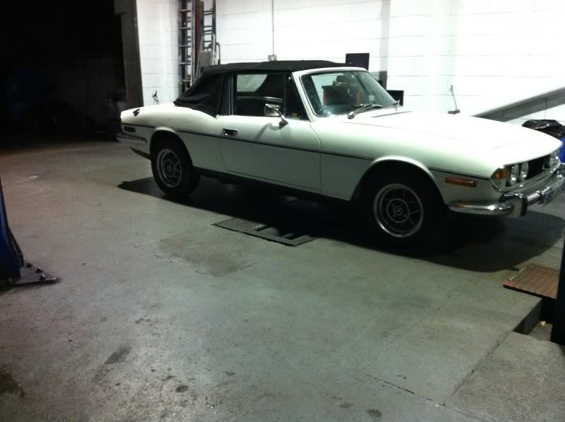

                I said before I would get a side shot. On the basis it is now stored, here is such a shot. It is currently on 185/70R14s which I believe are the 'wrong' tyres depending on which sources you believe.
                I shall see if I can definately confirm whether my springs are the Chris Witor items. Although with the success owners are experiencing with the HRS springs I am tempted to go with them instead.
                As for the height and camber issue, here is a picture .
                  It's definitely too low at the front rather than too high at the back and if you have lowered springs on the front this would be the outcome - with the HRS ones all round (and you should never mix lowered with non-lowered, unless building a dragster) the car is more or less level.
                  Also, there are only new brackets to substitute the outer ones on the rear subframe which align the camber perfectly. If you are going to fit this kit I would also suggest if you havent already fit poly flex bushes as well - they take away all the rear end twitch. I've cheated slightly here too in having the Datsun Drive shafts which are properly engineered unlike the stag ones.
                  I've no experience of the Witor items save the fact that most of his stuff is designed for the 2000/2.5 range which in all models will be slightly heavier at the back than a stag so I am not sure his rear springs/rates are stag compatible - he'll tell you though.
                    From the pictures I would say my stag is about the same height at the front, but much lower at the back. I also have 185/70 x 14 tyres fitted, and there is about 1 inch between the top of the tyre and the arch, it looks like you have about three inches.
