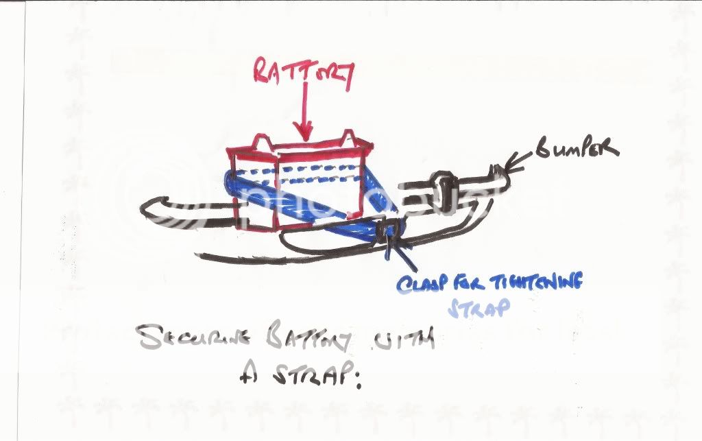

                Did away with the Battery bracket years ago, and in it's place I have a strong strap that holds the Battery in place and is securely tied to a piece of the bodywork just beneath the bumper. See attached drawing. Battery has never moved yet, and to release it you just have to slacken the clasp that I position just below the bumper. There is a gap in the Battery compartment that allows you to wrap your strap all round the battery then feed down and to the front of the car where I secure it to the centre piece just below the bumper. Simple yet effective.
