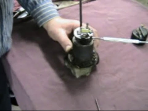

              It's not quite the same as the Stag, but the principles are the same in this video if you can bear with the chap (in my case, a tap to the pump seemed to cure it!):
