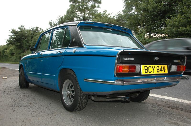

    On a slightly positive note, my Dolly Sprint did get an MOT today with flying colours! I'll put a few pics up as well as putting up a dash shot so you can see what gauge I have in the Stag (I believe the Sprint uses the same stabilizer/sender and wiring arrangement as the Stag).

    Hi Chas
    the steering wheel on your Dolly looks good. Thicker rim than on a Stag? Is it original spec or a Motalita?
    Your photo also made me think that wooden door cappings would suit the Stag.

                  Cheers for the replies chaps, although the temperature gauge yesterday did not help matters after I left the garage with a couple of new body modifications. Nothing that cannot be sorted though .
                  Originally posted by Bandit1200 View Post
                  Hi Chas
                  Stock steering wheel Steve . It even has the blanking pieces fitted to the centre of the wheel just like the later Stags did. I am not sure if it is thicker than the steering wheel but the picture certainly makes you think that it is the case.
