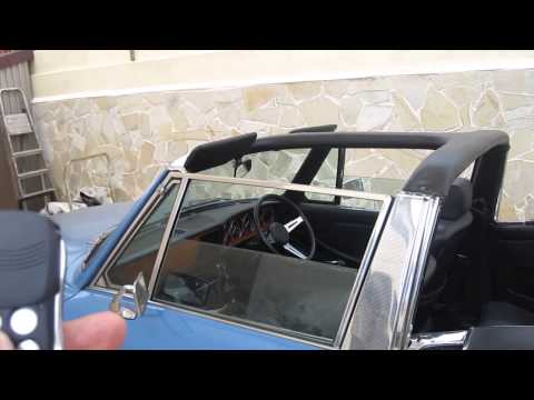

    Hi all,I am fitting a keyless alarm system to the Stag at the moment and one of the connections is for window closing marked - output. I just wonderd if anyone has fitted a similar alarm and where they connect this wire to ?? Cheers Graham

              Cracked it, with the aid of a couple of change over relays, now the windows close when you activate the alarm

                        Hi Graham, how does it know to switch off at the top ? Captain Thick.
                          Timer?
                            Originally posted by PaterB View Post
                            Timer?
                            Can't be, windows move at different speeds. M.
                              Alarm electronics moniter the current draw of each window motor as they close and stop the motor when the window touches the top of the frame.
