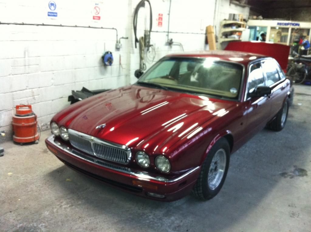

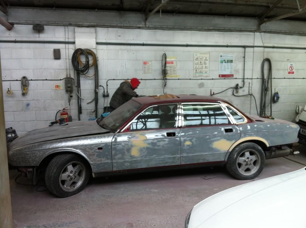

          I just had my dads jag repainted for him this year - It had a bare metal job as the paint on it was rough and i wanted it to last as your right they do drive really well.
          His one has the switchable sport box as well which makes it shift
          I also managed to pick up a set of same (Celtic) wheels as your one has on eBay the other week for £40!! I am getting them refurbished before they go on it.
          Here is a couple of pictures of it below
            Lovely colour Darren I think they are a lovely looking motor and incredible value for money at the moment. Mines got the sport box on too and she lifts up her skirt and go's!! All without too much noise and fuss. My next job will be to change the back boxes as they are getting a bit flakey and one is sounding like it's leaking now. Not bad though they are the originals!
