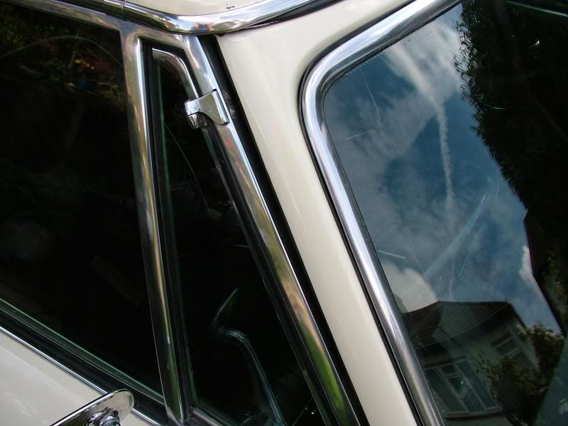

    Picked up my new toy this week, one problem I have noticed is the window frame on the drivers door does not seal against the windscreen surround as per the photo:
    Is this an issue with the glass frame and can this be adjusted inside the door ?
    Or do I need to some how bulk out the aperture with more seals ?

    There is some adjustment on the lower end of the frames that might help close that gap. Also there should be a seal that glued to the gutter panel but lots of cars have that missing. Someone will be along with a picture shortly I am sure. Mine is currently stripped down so I can't take a pic.

      Also looking at that pic its missing the gutter, is that just a trick of the light?
        mine has the same gap I just thought its how they were
          Ian's right though, where's the gutter?
            I rather think that having no gutter might actually be a good idea ! Less wind noise, less chance of rusting and I'm really not sure quite how much use they really are Looks neater as well.
            I had a gap like that and a mixture of adjustment and seals cured it.
              There is a seal there but it is not big enough to fill the void, the door top sticks out further on the drivers side than it does on the passenger side..
              Some fettling is required meethinks.

                    Well I took the door card off and found there was no more movement to be gained, the frame seems to be at its furthest points..
                    I have added another seal at this point so at least I am watertight and draft proof on that side now.

                          If the frame will not adjust further, but is still sticking out there is another way to close the gap. Open the door and put your knee against the inside near to where the vertical frame at the rear of the 1/4-light enters the door. Grasp the top front corner of the frame and pull it towards you firmly. This sounds drastic, but is nothing compared to the methods used on production lines before modern technology took over.
                          This is only a suggestion and I accept no liability for any subsequent damage caused - although I have successfully used this method myself in the past.

                            I tried this to some extent but didn't want to Break anything.. may give it a go as the weeks pass by..
