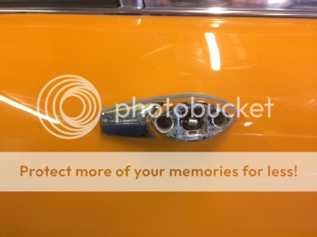

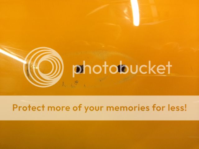

                Just popped out to the garage for a proper look
                I can see the screws to remove to mirror base so I soaked them with a bit of easing fluid
                As the screws came away I heard something drop into thedoor!
                It would seem the nuts used to hold it in place weren’t the fixed sort !!!
                So the door car will have to come off after all!

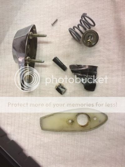

                PO bodge by the look of it there was cardboard and tapestuck in the mirror base!
                Just my luck

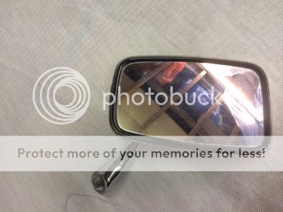

                Here’s the mirror which came off
                Never what you think it will be is it! Never that five minute job

                  Hi Glyn,
                  If yours is like this, you simply have to turn the arm 90 degrees, against the springback pressure, and that exposes two screws. Those go through the plastic baseplate which has fittings a bit like Rawlplugs and so, once unscrewed, the plastic baseplate should come away as well - that's the theory !
                  Seriously, the baseplate will probably be stuck but it can be persuaded out and a new one - which I think will come with the mirror - can be simply fitted.
                  Good luck. Cheers.
                  PS Oops, posted a bit too late However a new plastic baseplate may well fit ok Glyn. The holes should be round but you may find it'll fit ok. Worth getting your new one before you start stripping the door

                    Mine didn't have what I think should have been captive nuts or similar (they are now in the bottom of the damn door)

                      Hi Glyn,
                      Yep, I've used one like that. As you may be able to see, the base plate incorporates the fixing so there are no captive nuts as such.
                      Once you get your new one it will all become clear !

                          fitted today and yes Julian it all made sense. I think the plastic lugs had broken off the one I took off...my excuse for not understanding anyway.
