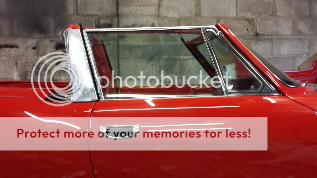

                      thats a good fit,you see a lot of cars and the frame is not a even fit round the b-post
                      dave
