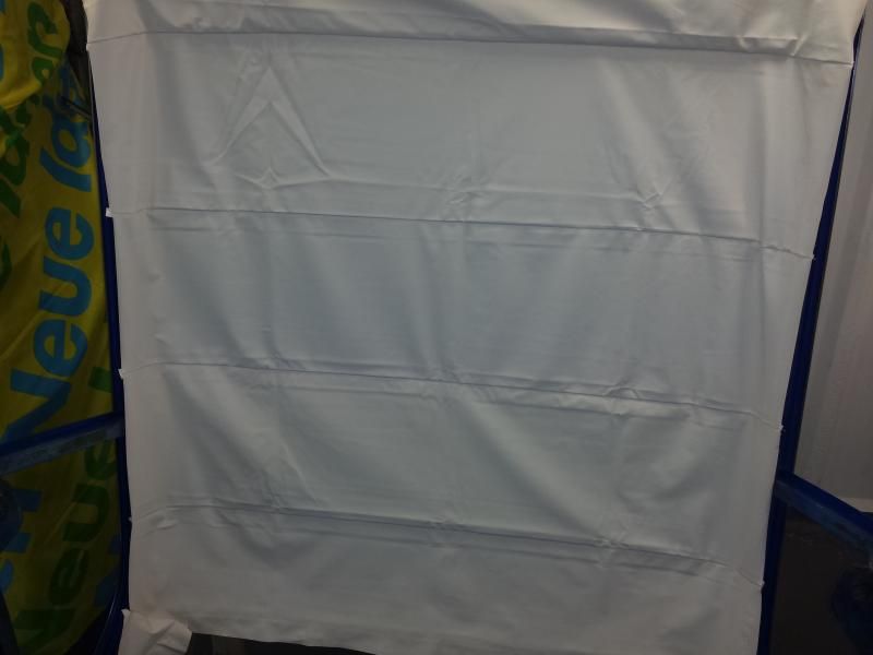

    I have never fitted a headlining to any car before although I've done plenty of trimming so have a vague idea with material etc.. I figured I need to cut the pockets for the bows but not sure if I've cut enough? looks like I have a lot of "un-wrinkling "to do! hope they will come out when stretched?
    any tips would be welcome as I don't want to stuff it up!!

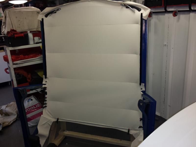

      thanks Julian, this is where I'm up to.. i took the plunge and went for it! so far so good apart from some of the stitching came apart from enthusiastic stretching! if the material didn't have so many wrinkles from poor packaging it would of gone better.
        Looking good Mark. Don't think mine was any better !
        ps I got mine warm when fitting and it shrunk a little taughter when it cooled.

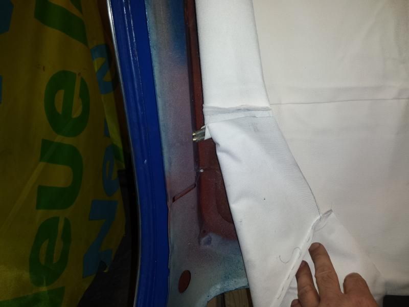

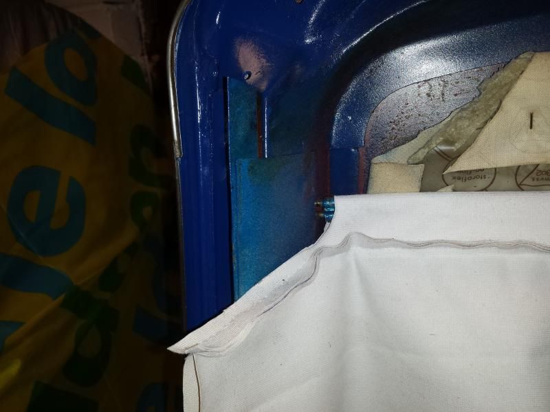

        i found the parts on the C pillar weren't quite the right shape.
          yeah I used my trusty old hair dryer to work the creases out a little. tomorrow I'll tackle the C pillars and fit the front seal and channel. I'm not sure weather to buy a new rear screen seal or not yet, mine is in 2 pieces so will need gluing together at the bottom corners, not sure if gluing them is such a good idea!

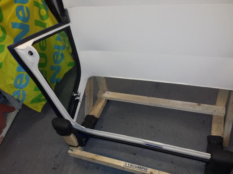

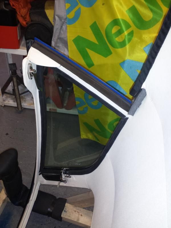

            I got my board today to finish off the trimming round the bottom edges, the long thin one is about an inch short on either end!! I would have made my own but didn't have the correct material to hand.. I think the best plan is to fit the centre section 1st and not fold the material over the ends and stick it down the metal instead and then fit the sides over. and then be done with it and accept it for what it is! I'm still trying to figure out what the hole on one is for too
              all gluing finally done! what a job, turned out better than I hoped for and not too bad for my 1st ever headlining! one popout fitted and front and back seals fitted, these are the original seals that are in superb condition so I just cleaned them and refitted them.
