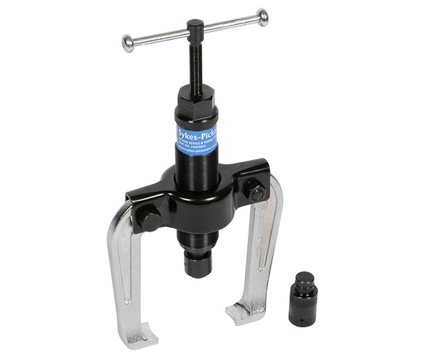

                  If the pulley is really tight, then as Nick says, a plate type puller is best, but I've always been successful with my Sykes-Pickavent hydraulic 2-leg puller.
                  Hydraulic 1500 series two leg puller powered by 1500 series hydraulic ram Wide range of automotive and industrial applications Spread 50-100mm Reach Max 100mm
