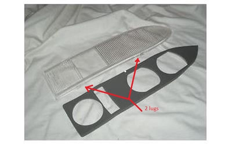

    Just cleaned the lens and reflector on the rear of mine...
    There are 4 notches 2 along top, 2 along bottom. and the pointed end has a protrusion that sits under the chrome holder also.
    Red arrows

      Hi Allan - thanks for this - how did you get the lens out..?
      Red arrows
      Allan

                Andy,
                If you are just changing the outer lens it can be done from outside. There is nothing to be gained by removing the light unit. The old lens is probably brittle and may crack further, but as you are replacing it that doesn't matter. Just take care when inserting the new one. Pointy end first, then feed the four lugs in carefully using a wide blade to squeeze the lens slightly. Best to do it when it is warm so that the new one doesn't crack also.
                  When refitting mine I wasn't happy with the way it seals depending on those lugs so I ran a small bead of clear silicone around the outside . A steady hand and masking tape and it doesn't notice but gives you extra reassurance .
