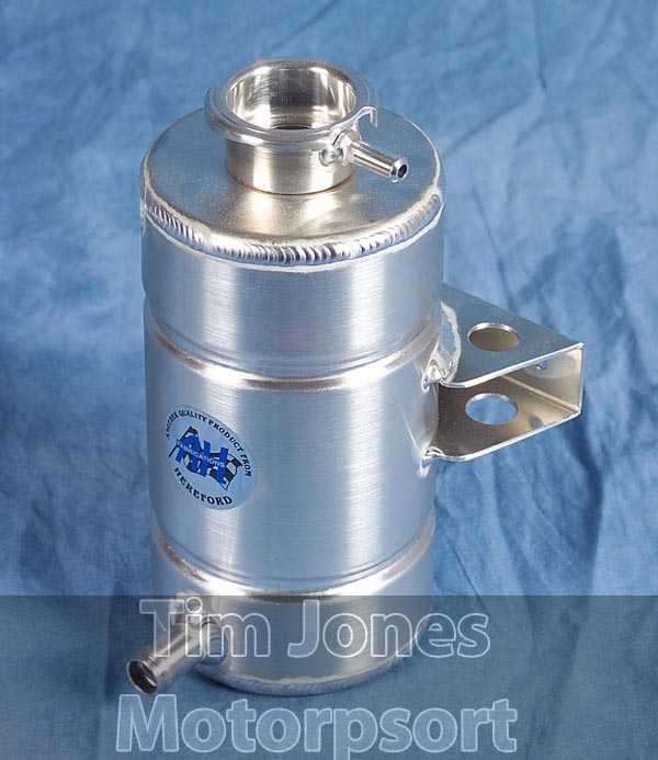

    Is there any reason why just moving the expansion bottle to a higher point in the engine bay and using the original connection to the radiator is not done?
    I was thinking of using a bottle like this and mounting it near the fuse box this would mean no extra pipes or connections
    Any points, help in the right direction will be appreciated.

        I think you are confusing the expansion bottle with a header tank. If you want a header tank you will have to do the plumbing.

          No depends whether you are talking early mark one stag or mark two stag.
          The early mark one stag does have a true expansion bottle with no pressure cap, the mark two a header tank with a pressure cap that can also be called an expansion bottle with pressure cap...if you know what I mean!
          If your bottle has a pressure cap there is no reason why you can't raise it higher with an alternative design bottle connecting to the original small bore connection on the top of the radiator only.
          Thats what I did originally over 20 years ago to good effect. Before I was always topping up the originally bottle, as soon as the turret mounted tank was fitted I never needed to top up again between complete flushes.

              Mike, if you were always topping up you must have been losing water?
              As you will know, (Mk2) owners often check the levels by looking only at the expansion bottle, andthe proper way is tocheck the level at the filler plug on the rad. The level in the expansion bottle is not critical, but should not be more than half full to avoid coolant loss.
              To improve the Mk2 Stag cooling system, you need to have a proper header tank fitted as high up as possible. The header tank should have two pipes, to allow flow and return of water. The tankserves to:
              1. Ensure that there is a reserve of water above the engine levelin case of amoderate loss.
              2. Provide a reliable visual indication of water level in the system.
              3. Serve as an effective filling point.
              If you simply raise the expansion bottle to a higher point, then due to the small bore pipe, that goes into the radiator, air locks will occur (there is nowhere for the air to escape exceptback up the pipe)and it will be difficult to fill the system. The level indication may be misleading due to possibilty of air locks. As there is no flow in the tank the addition of antifreeze will not mix fully.

                  Having a flow and return is a better option, infact that is what I have now.
                  However not having a flow and return but still having a head of water higher than the water pump is better than the original bottle position however.
                  Why I used to keep on topping up, then never again with a higher tank I do not know. It was actually 22 years ago now!

                      I know many have used the original expantion pipe to good effect when fitting a header tank but i still think you cant beat gravity to do it's thing with the system.A pipe off the bottom of the header tank going down to a low point in the rad and a pipe coming of the highest part of the rad letting any air out of the system to collect out of harms way in the header tank .that way you know the system is full with no airlocks ,
