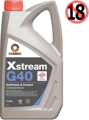

      If you must get it from Halfords it looks like their Comma Xtream G40 is Monoethylene Glycol.
      Shop the latest Comma G40 Antifreeze and Coolant Concentrate is an ethylene glycol based antifreeze at Halfords UK
