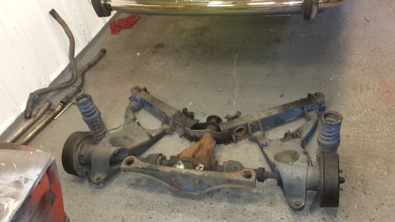

    I just can't help taking things apart had a bad oil leak and things were looking very grubby underneath, I also spotted a small hole above one of the rear springs so will tackle that and give things a good lick of paint here and there!

        ive got to take my rear suspension out as well, to fit a new boot floor,i was going to take it apart,because i thought it mite be to heavy for me to take out on my own,did you have any trouble taking the whole thing out and were you on your own
        thanks dave
          Dave I did it on my own with my trusty jack. I don't renember any particular problems except keeping it balanced on the jack as I lowered it
            Mark, roughly how long did it take you to remove?
              2 hours, not sure if this is good or bad but things went smoothly I guess, exhaust practically fell off much to my relief as I expected a battle there! yes did it on my own with a regular trolly jack, it would have been easier with a larger jack (I usually borrow my friends) but I got by..
              the only thing I would do different is take the front bush bolts out altogether as they got n the way as I juggled the lot on the way down!
              the whole lot is stripped down and pressure washed now (horrible job!). drill with wire brush and grinder with flappy disc is next to remove crusty bits! I could just send them off for powder coating but that would be expensive and just take too long and I want this back on the road asap
