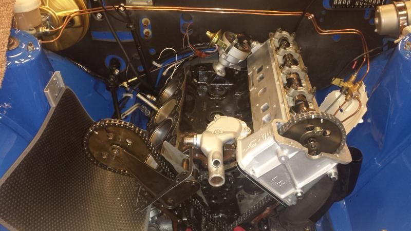

    As part of my engine bay spruce up I want top replace all the front end brake pipes (the current ones are in a bit of a mess), but looking for replacements throws up a lot of options and prices. Are there any advantages or disadvantages to each.
    Automec, seem only to be available as a full set and quite expensive
    Copper - cheap!
    Kunifer (cupro nickel) slightly dearer
    Fully polished Cupro nickel (does fully polished look different to none polished?) even dearer.
    Also, any tips on straightening the coils and getting the right shape for a neat installation. I have seen a few pictures of superb installations so hoping to replicate those standards.

                I appreciate your thoughts all, and that does look very neat Mark.
