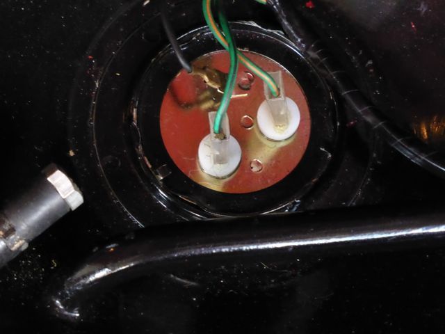

          Hi had a wee look at the fuel sender wires then put the boot board back down !
          The 2 wires as below - if I remember you would have the ignition on & ground one of the wires - well that was the temp sensor on my old TR7 - then gauge will either go to full ( I hope ) so that would tell me gauge is ok then next would be to have aloof at the float.
          The 3rd Wire I assume (the black one) is the earth - what are the others to save me ploughing through the Manual wiring diagram.
          Any pointer from any knowledgeable sparks
            Neil,
            Green/Black wire goes to the fuel gauge (which should read full when this wire connected to chassis and empty when wire disconnected).
            Black wire goes to the chassis ground.
            Green/Orange wire goes to the low fuel light (which should come on if this wire is connected to chassis).
            Disconnect the green/black wire and with the ignition on a voltmeter from this wire to the chassis should read 10Volts if the voltage regulator is working.
            Disconnect the green/orange wire ans a voltmeter from this wire to chassis should read 12V if the warning lamp is working.
            Simon
            PS both the above voltage checks need the ignition to be on.

                    Hi Simon,
                    Carried out all the tests you suggested & all is working - the pesky float had a small hole in - looks like a common fault - sharp bit on arm as previous posts.
                    Once again thanks - now can rest easy the voltage stabiliser is ok therefore the temp gauge too
