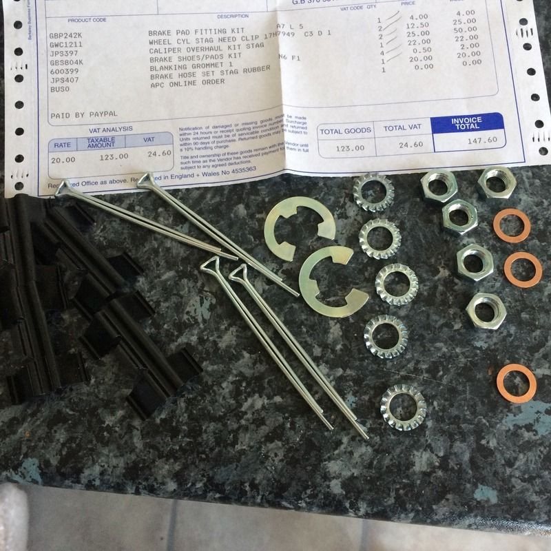

ordered some bits from paddocks what are these?
    slowly ordering bits as you can see in pic i ordered flexis shoes cylinders pads caliper rebuild kit, brake pad fitting kit
    what are those two big round clips for? on receipt it says next to cylinders need clip?
    and the nuts washers etc??

    The clips are for the rear wheel cylinders, the nuts and washers look like they are for the brake hoses.
      hi they hold the rear brake cylinders to the backing plate,good luck fitting
        worked it out circlips hold on cylinders lol
        the flexis 3 have a copper washer one end and bolt washer the other
        but one flexi with the only one with metal around it just has a bolt each end? looking at the pic on paddocks??
          Single flexi for the rear brakes?
            ???? i just ordered a kit of 4 from them? whys one different?
              Like MILOTHEDOG SAYS GO AT THE BACK OF THE CYLINDER.YOU WILL ALSO FIND THAT THEY ARE A BUGGER TO GET ON UNLESS THERES A TOOL WHICH I DONT KNOW
              ABOUT.GOOD LUCK.
              JIM
                There is a tool and I have one..... Makes life much easier
                  If you dont fit the c clips properly the slave will wobble about when you are not braking and in my case cause odd noises as the shoes kissed the drum.
                  To fix I ended up removing the backplate and installing the cylinders and c clips on the bench. Gave me a chance to paint, inspect outer driveshaft UJ/hub, lube up splines, check threads that secure the hub to the trailing arm etc etc etc
                    Agreed with Russ, the special tool makes it easy. I think Moss sell them (same as on MGB?). It says "17h7949t" so could be the part number....
                    The rear hoses are different left/right. The right one inner end goes onto a pipe so has a flare type union. The left inner end goes into a 'T' piece so needs the copper washer. That end of the hose doesn't have the cone shape and the thread is shorter with a flat for the copper washer to seal on.

                      Be careful when fitting the brake hoses. Someone, in the previous ownership of my Stag, had wrongly fitted one of the rear flexi hoses and done the union up first and twisted the hose to tighten the other end. This twist resulted in it rubbing against the suspension and causing this to happen.Brake Hose.jpg
                      It now has stainless braided hoses fitted (properly)!

                        cheers guys slowly getting there slowly
                          [ATTACH=CONFIG]33836[/ATTACH]
                          No brainier for £10
                            Or 30 minutes with a couple of bits of scrap on a lathe..
                              or whack them on with a flat blade screwdriver like I did! easier said then done with the backing plate off the car and on the bench!
