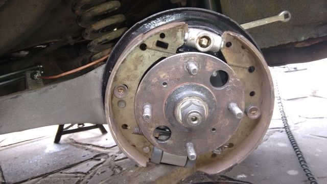

    Anyway l removed the backplates and transferred the shoes and springs, knocked the auto adjusters to fully off and adjusted the brakes on the manual adjusters and found the handbrake cable needed slackening right back to the end to reconnect to the lever - a positive sign! Also made a pair of new flex to wheel cylinder metal lines using one of my nice Xmas prezzies, that makes brilliant brake flares in seconds....

    Here is a PIC of the converted brake....

    looks like a great mod for the troublesome handbrake well done Russ

      At least you have got a decent size hand brake leaver now and I see you have managed to mount it at the top of the back plate and you have it chromed, It will be interesting to see how you are going to manage to attach the cable though.
        You are such a lever..I mean knob, Graham... Has it really been so long since you've seen a brake adjusting spanner?

          It went for MOT this afternoon, and passed with flying things, as one should expect, but the interesting thing was the brakes..... the rear brakes were 30% better than last year, and the handbrake threw the car out of the rollers! This has never happened to me before, and the tester remarked on how good the handbrake now is with the modified backplates - I'm just pleased the bloody thing will stay put on a hill now and not put pressure on the park pawl in the transmission!!

            I like the idea of the manual adjusters, are you going to do a kit?
              No John, but will convert the odd set for friends - currently doing a set to take to Tenerife next week...
