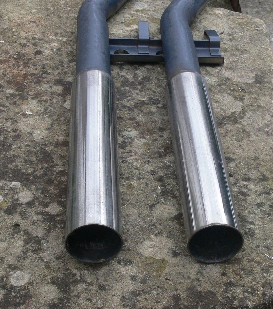

    Another question which I have been thinking about - this Stainless Steel Exhaust System is for sale on an auction site - mine has the same greyish colour ( paint ?) on my SS System.
    My old TR7 SS Exhaust was shiney the complete length - why is the Stags 'part painted / coated' ?
    What is the coating ?
    I've never seen coated stainless exhaust for a stag before , I'd say the seller has painted them to improve the overall look ,for selling purposes! Graham
      I've had m exhaust fitted for a long time . It's not painted with anything. I've never seen a stainless system painted before

              There are 2 basic distinct types of stainless steel Austenitic and Ferritic. The former is basically an alloy of Iron, Chromium, and Nickel (18/8 Cr/Ni being a common type). Ferritic Stainless is cheaper as its basis is an alloy of just Iron and Nickel , whilst it is far more corrosion resistant than mild steel it is less so than Austenic types but this depends on operating environment.
              You can tell the difference by using a magnet. Austenitic grades are non magnetic but Ferritic grades are * . Checking the stainless exhaust systems on both my Stag and Daimler I found that most of the systems are magnetic and therefore ferritic but in both cases the tail pipes are non magnetic i.e. Austenitic

                The short version is 316 stainless is more resistant to corrosion than 304 but does not hold a sharp edge, most stainless exhausts are made from 304 which will hold a better edge, so when your exhaust has had its day you can always use part of it to carve the Sunday roast
                  The system on my Stag and the system on my Landy are both stainless. Both systems have nice shiney silencers, but on both systems the pipe work is very dirty looking with obvious rust in places. I suspect the pipes are made from a different grade (304 to use Grahams reference). The system on the Landy I fitted about 18 years ago. I bought it from Rimmers with a lifetime guarantee. Still have the receipt and the Land Rover, I suspect I will make a claim one day not too far away as the tail pipe is starting to get a bit tatty. It will be interesting to see what hoops I have to jump through to get them to honour the guarantee!
