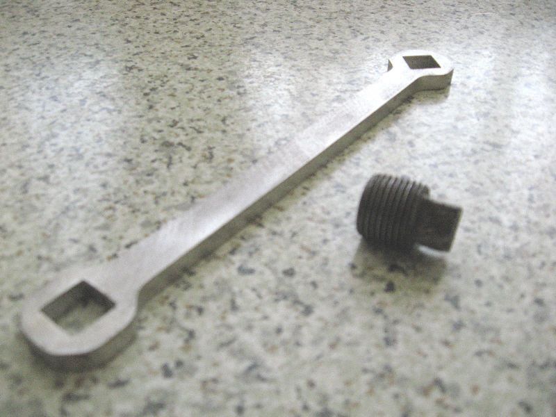

                      And as also been said it reduces the hole size so restricts the flow of oil out of the sump. I always like to get the engine thoroughly warmed up so the oil is nice and thin then remove the sump plug so that the oil literally gushes out and flushes any debris out with it. You still have to get under the car and still have to catch the oil so apart from saving a few seconds with a spanner I personally fail to see the advantage. I've never had a problem getting the sump plug to seal so have never used PTFE tape on it either.
