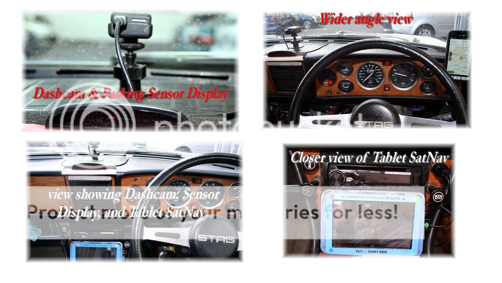

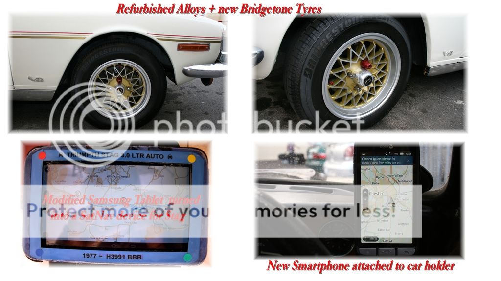

            Above and below pictures show what I have been doing to the Stag recently.Made some modifications to an old, little used Samsung Galaxy Tablet of mine, in order to use it in the Stag as a SatNav display (and also to play music I have stored on it). Decided against using a Tablet “car holder” I got as a present, as didn’t like where it was positioned, and instead placed the display in front of the heater controls as I never need access to them (they are permanently set to cold & fresh air).
            The Tablet is held in place there with Velcro, so can easily be removed when leaving the car, but I may yet tidy it up a bit, and colour the front darker.The new twin USB cigar lighter plug feeds both the Tablet and the Dashcam, or alternatively a smartphone when placed in it’s holder at the bottom of the windscreen on the right, keeping them charged up whilst driving.
