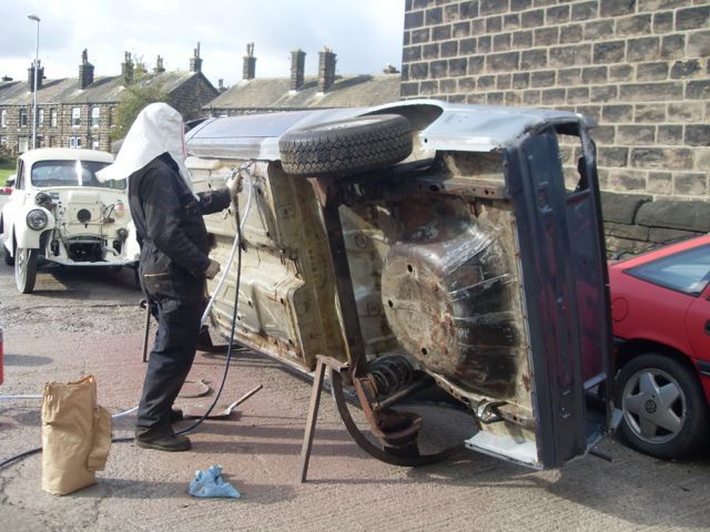

            I manually removed the underseal with a heat gun down to the primer then the shell was soda blasted to get rid of the rust.
            That saved the amount of soda material.
            On a stag the only bits which will be left if restoring the shell would be the rear quarter panel - soda is a mild media which won't distort the metal - yes dipping chemical can creep into the seams but think the companies who do this have it covered now.
            Me - I would strip car down to it's bare bones get it soda blasted - as you will have found out - professionally is a higher cost but comparable with DIY.
