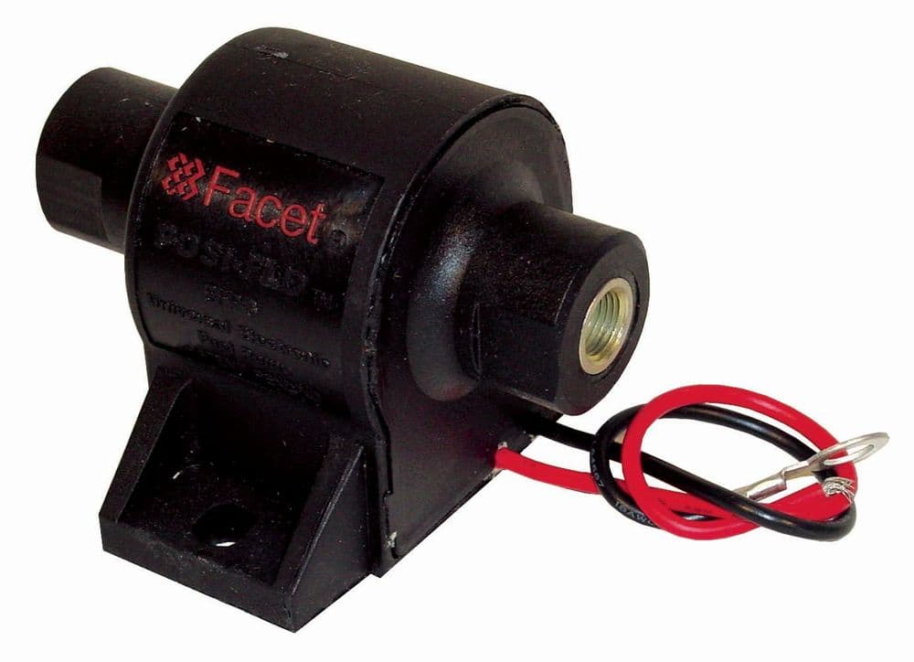

                    This is the low pressure one I have used for the last couple of years, very easy to fit and no problems at all. A bit more than a tenner though!
                    Facet Posi-Flow Electric Fuel Pump 1.5-4.00psi 60104
                    Facet Posi-Flow Electric Fuel Pump No 60104 - low pressure 12 volt This is an outstanding lightweight universal Facet electronic fuel pump with
