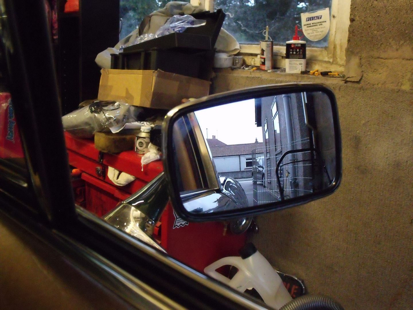

    Hi,
    I've got a set of washers from LD parts. Can someone please tell me how to fit them? I've loosened the nut on the mirror but don't see how to separate the mirror from the stem to fit the washer?

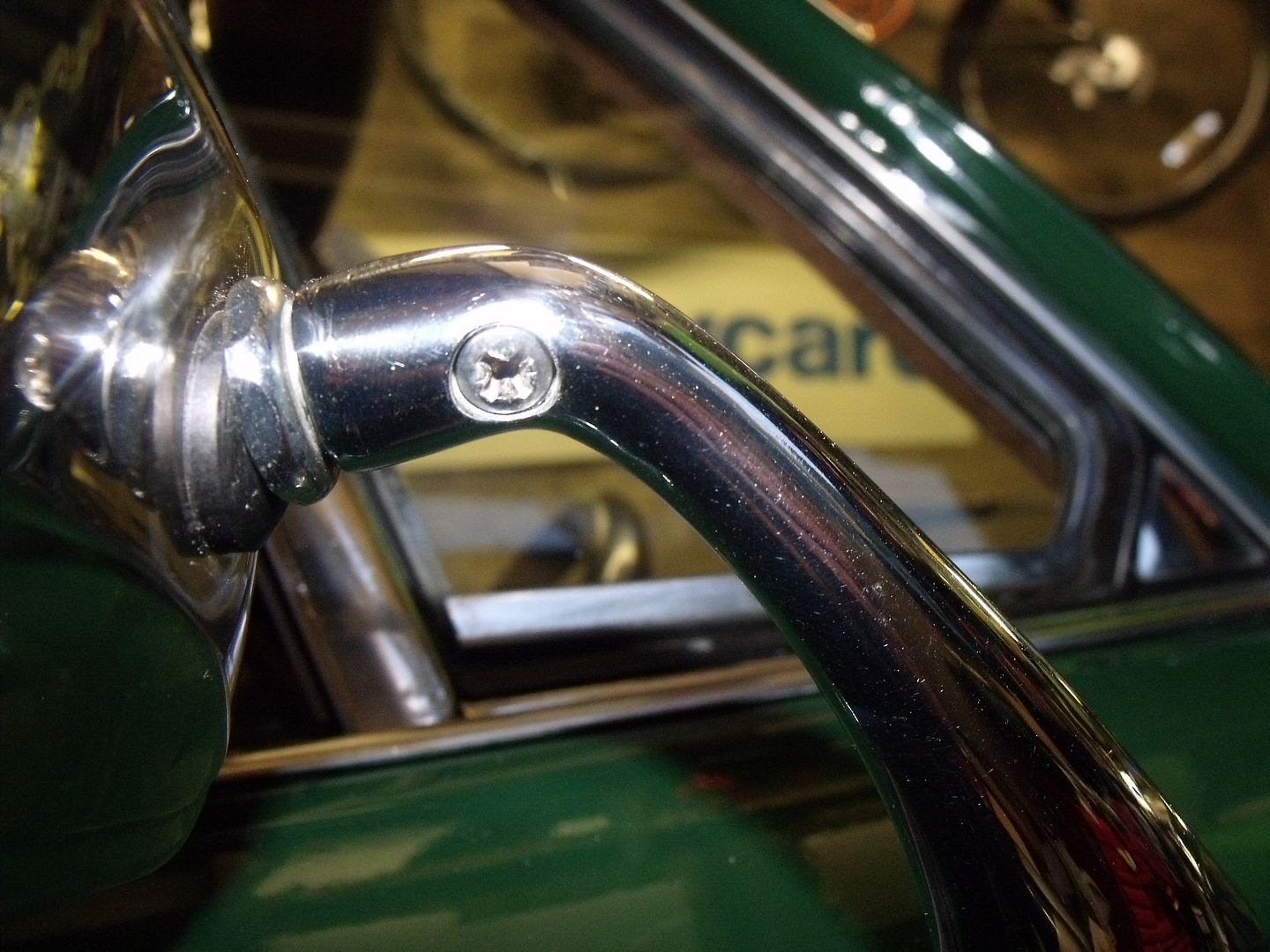

    Hi Graham,
    There is a small screw securing the arm to the part of the mirror with the nut on. You need to remove the screw and pull the mirror out of the arm. You then fit the washer under the nut and reassemble it.
    Tony

        Hi Graham,
        I have just re-read this! No the screw is in the arm that comes off the door, it is a small Phillips screw just below the part with the nut on. I thought you were on about the nut and the rubber washer!!!

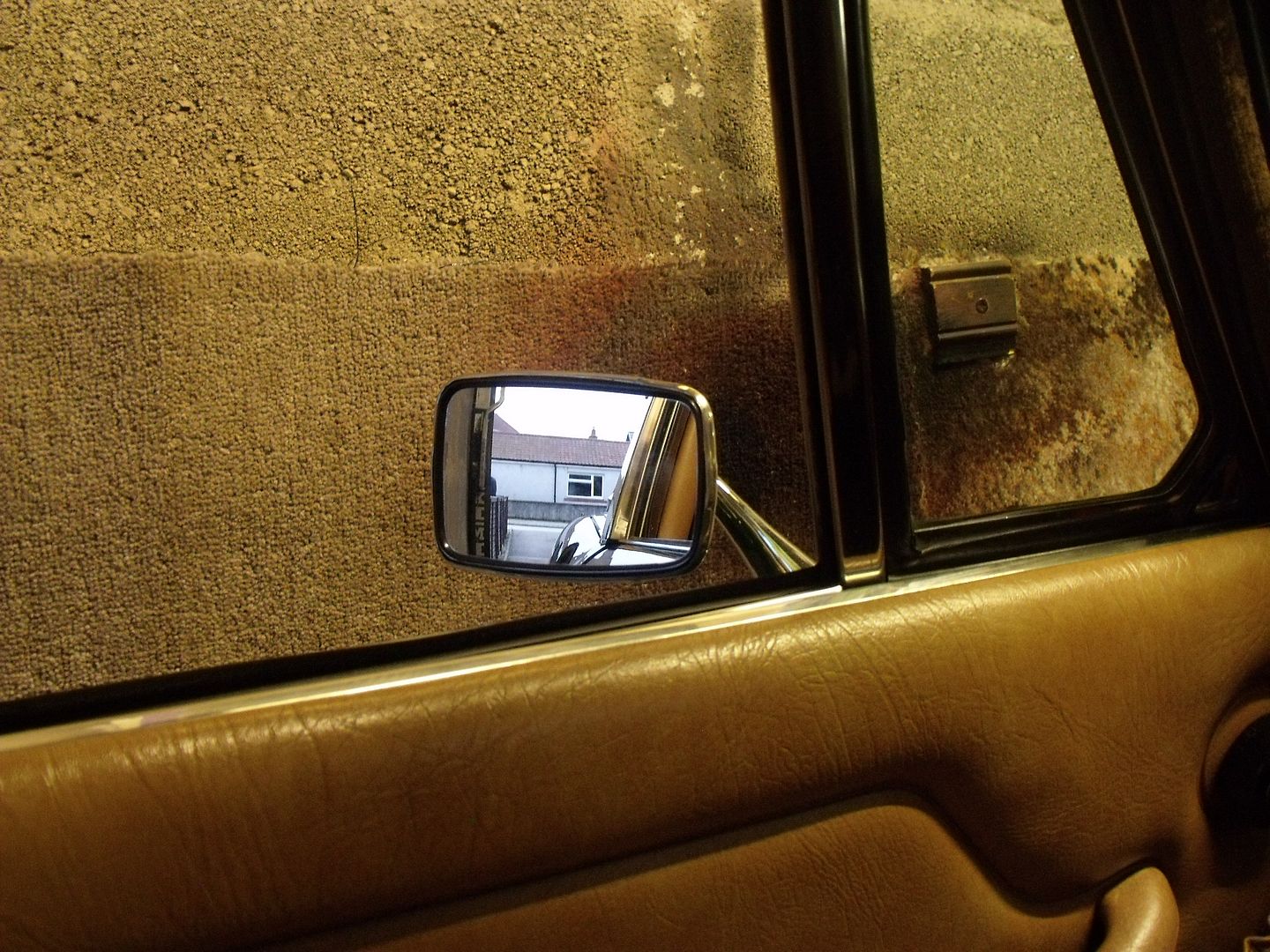

          Thanks Tony - I've found the screw! God knows why I did not notice it before! Washers all fitted now, and my mirrors are no longer just ornaments on my doors! What as difference!
          Graham
