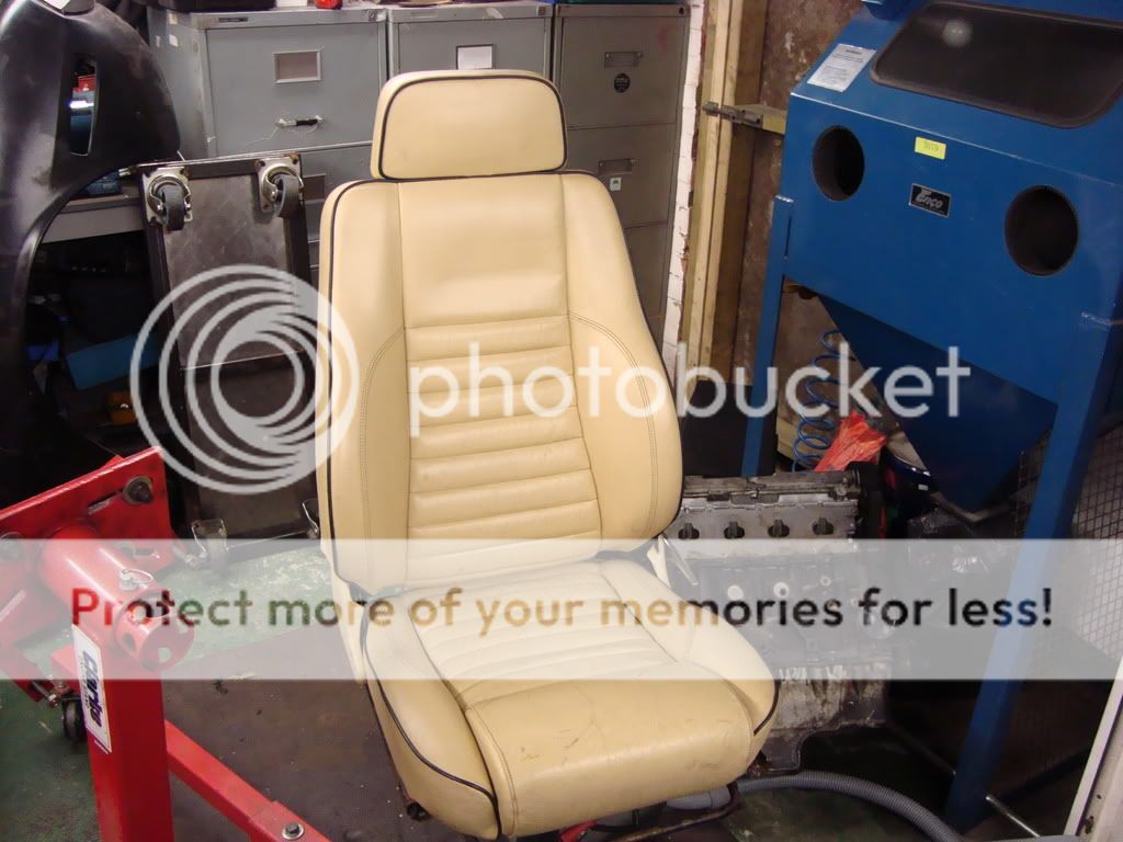

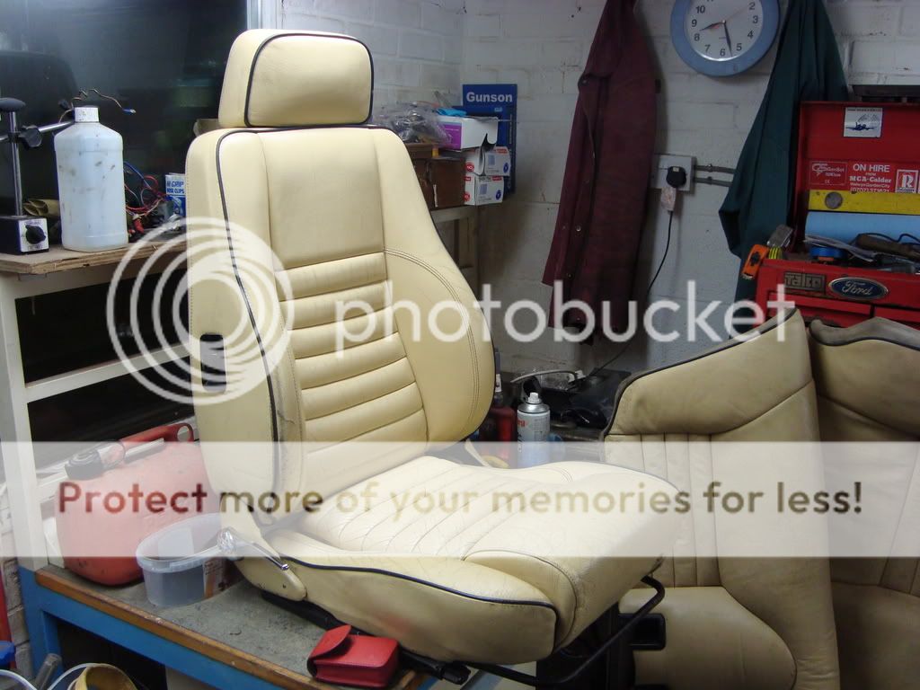

              steve.....................ps will post some pics before and after when done.
                this is the before shot,hopefully refurbed and black and fitted in a couple of weeks time permitting.
