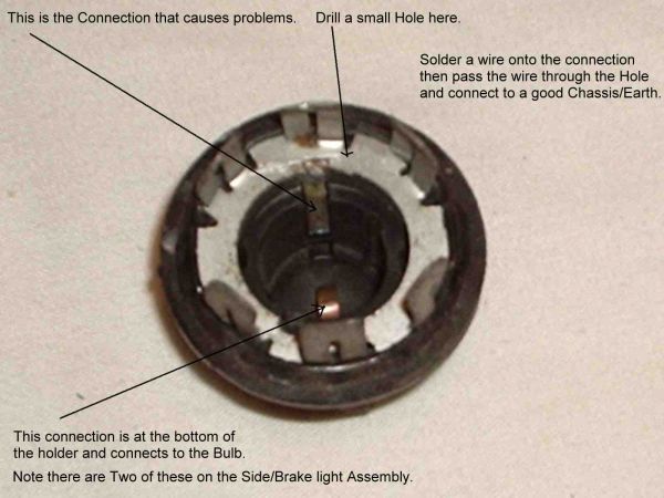

                  Another option to consider. If you do not want to purchase new holders they can be modified very easy. The main problem is due to the earth connection from the bulb to the bulb holder. This relies on tension from the bulb to press on the outer connection of the holder but age and corrosion causes problems. Easy way is to drill a small hole, connect ( solder ) a wireto the earth terminal then run the wire to a known good earth on the car. You could just solder the terminal direct but I have found that this does not last very long. Hopefully the picture says it all, worked on my Car.
                  Don Kennedy.
