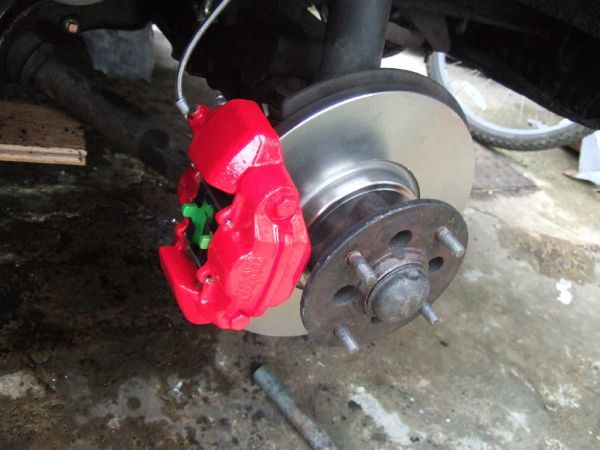

                I've put the green pads in, with a bit of copper grease on the back, but I left off the anti-squeal shims, basically because theres a rubber pad attached to back of each green pad and the shims would not have sat correctly. No squeal so far......
                Also replaced the both disks and calipers at the same time. ( Also replaced brake hoses with braided ones, new front wheel bearings, damper gaiters, rear shoes ).
                I'll update should squeal appear after bedding in of pads and a few thousand mile under my belt.
                Thanks.
                  1000 miles later and the offside set has started squealing, dogs start howling when I pull up. I've tried copper grease and the anti-squeal shims, no joy, so next weekend will replace with standard pads.
