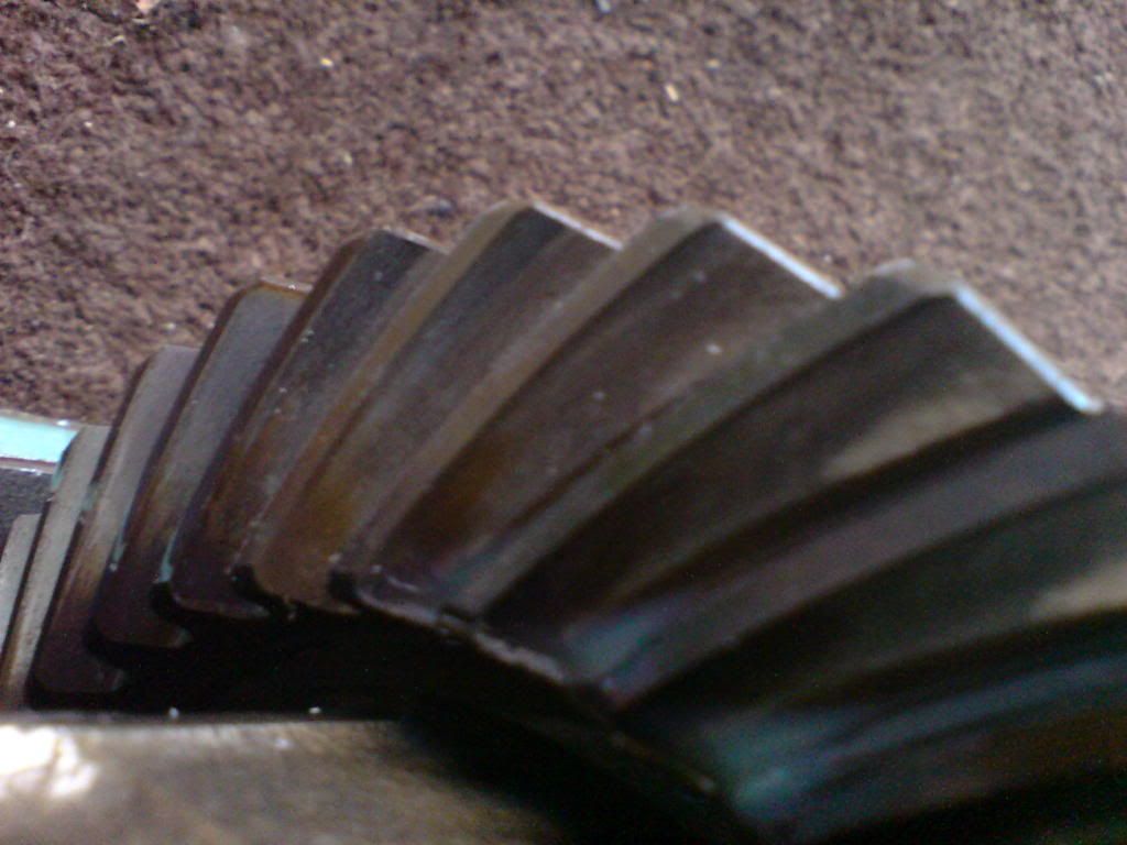

                  Hi Adie,
                  Here's the original, I haven't got a pic of the 'new' one yet but it feels a lot taughter.

                      I'd say there's something wrong with that mate. The contact pattern is very light and too far towards the heel. It also looks like there's been some heat at the toe of the teeth that shouldn't have been there. That sounds contradictory I know but the heat could be on the overun. Is the Pinion tail bearing (nearest the flange) OK? I'd say at some point it's been run dry and with poor pinion bearing support.

                          Dah!.....sorry mate didn't read that.........and now I think about it didn't I comment on this photo then too?
                          Try this for what it should look like:

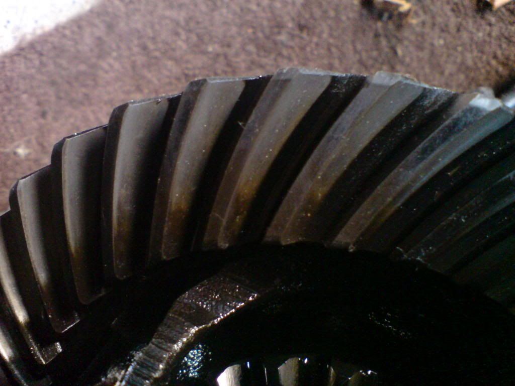

                              Here's a close up of my new diff and to my newly trained eye it looks a lot better.
                              Compared to the now obvious to me wear on the old one.
