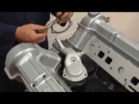

        Here's a handy video from Rimmer Bros on removing and fitting the pump once you've rebuilt it:
          The rebuild itself is quite straight forward, the harder part is acquiring the tooling to separate and then press the parts back together without compromising anything
