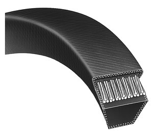

    LD Parts has a blurb on his website about lengths of belts. I bought 1 from Rimmer and one from LD Parts. both different lengths by a few millimeters . I have two Stags.
      spz1090 is a tad shorter than the PAS belt.
        Bought mine along with alternator belt from LD parts been on over a year and both fine.
          belts come in 10mm or 15 mm length variations depending on supplier, I get mine from a place in Grays essex J and M Belts think the last pair cost me £6
            Will try the SPZ 1090
            The one I was sent is 1110 and fits loosely, there is more then 10mm (x2) adjustment available so it should fit well
