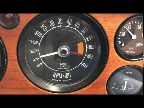

              Either way I have just backed it down ( Thanks John) to 650 rpm and she is ticking over nicely. Performance seems better in general too.
                You know when you got it right when she ticks over like this
                She was cold and when warmed up settled on 750rpm... beuatiful
                Driven all day, not missed a beat.
                  Sounds good, and decent oil pressure for idling when warm. You're entitled to that nice, warm feeling
