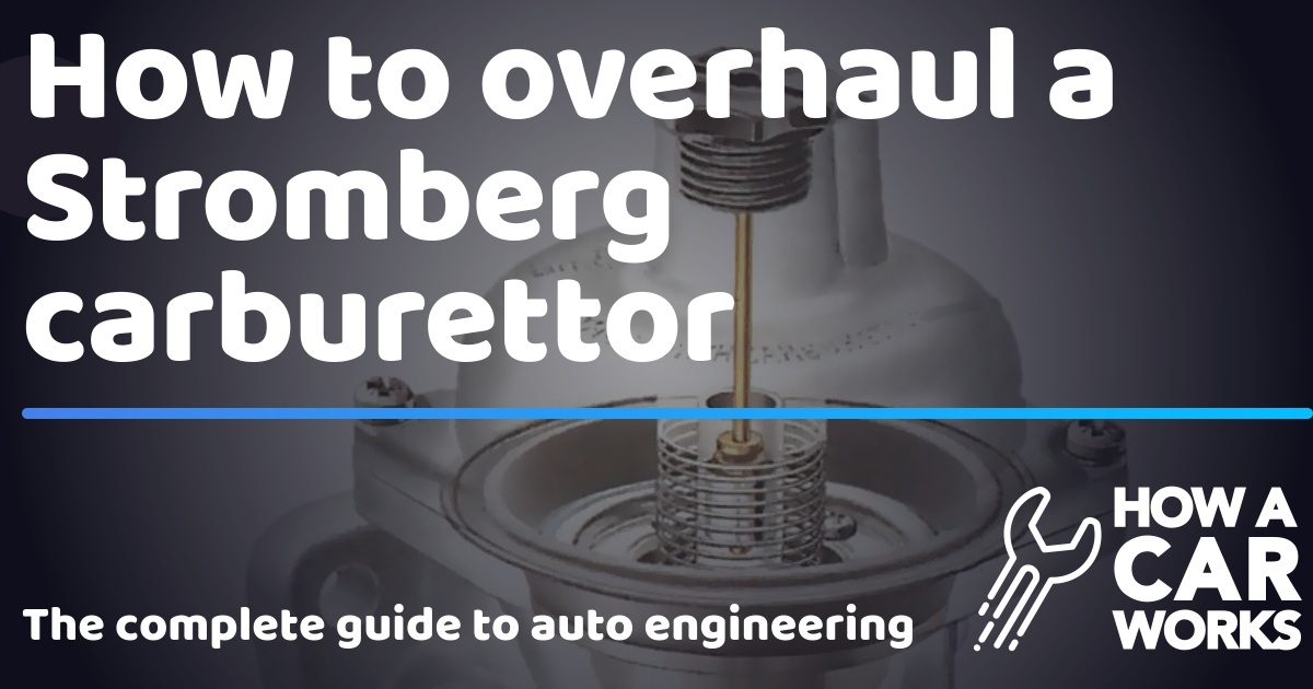

    The article covers a Stromberg carburettor overhaul and explains how to check, clean and service a Stromberg carb.
    Good find, thank's for the post.
