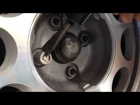

        Or you could use an air hammer with a pointed chisel end in one of the holes while aiming the chisel end counter clockwise. Somewhat like this:
