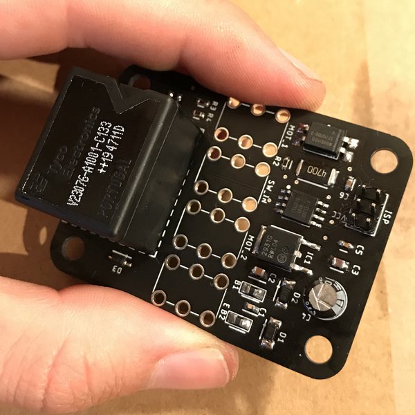

                        Arduino offers good potential for such projects - using cheap hardware and open source software with a huge active community keen to share.
                        Here is an example of an Arduino intermittent wiper controller fitted to an MG, with information to build your own, including the code.
                        Had to drive my MGA through showers of rain, and realised the stock setup wasn't ideal. In light showers the single speed wiper system was too much and I ended up manually switching the wipers ON and OFF to get single wipes every now and then. This delay module solves that problem.
                        It is very easy to attach just about any sensor you can think of, or drive actuators, lights, displays etc. The possibilities are endless.
                          Brilliant! A great read - might try it out myself one winter. You never know, I might discover I have a rare skill!
