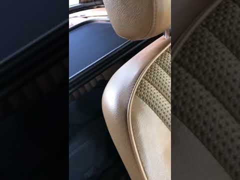

    Just had all my suspension bushes replaced with Poly bushes along with a load of other suspension work by a reputable Stag specialist.
    My diff is now whining at around 40-60mph which it wasn't doing before. I'm presuming the Poly bushes are the cause of this?
    If that is the diff noise that can be heard on the video rather than engine noise I reckon it is more likely to be bearing failure.
    Diff whine tends to be an even sound whereas that one seems to be pulsating.
