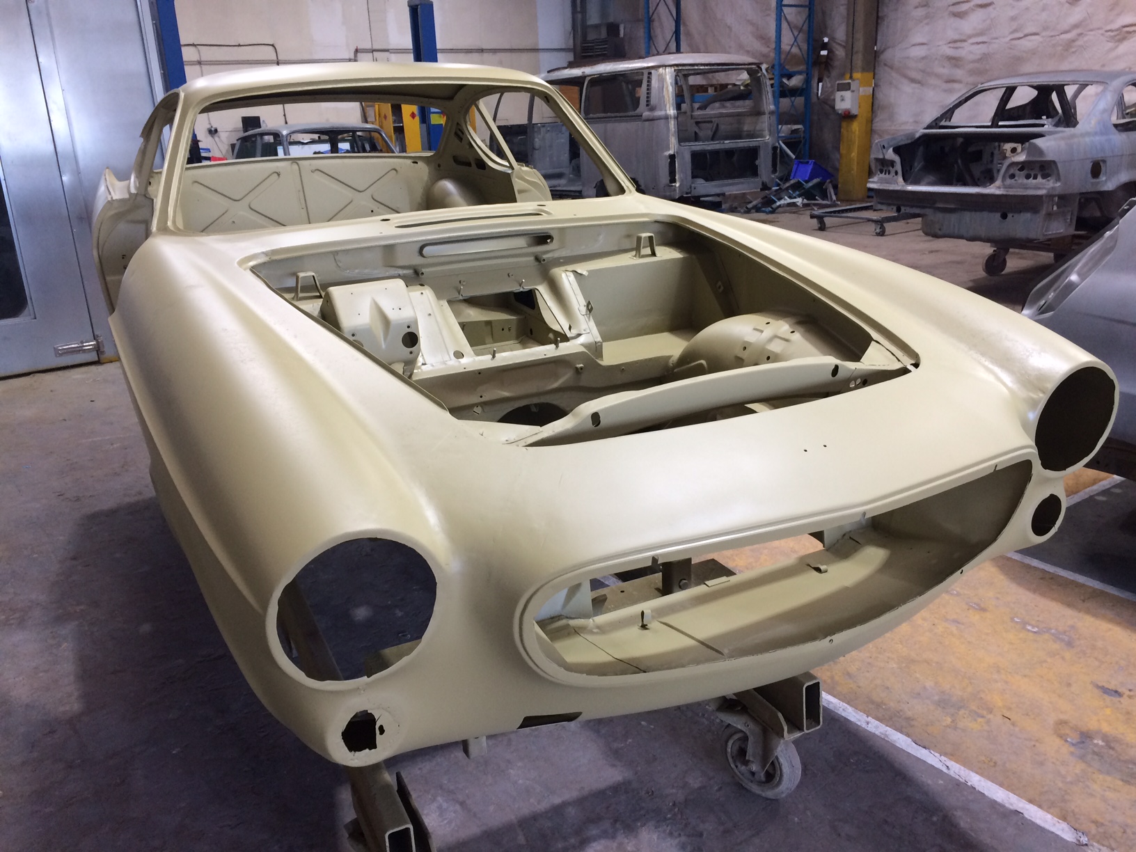

                          Three years ago mines cost £1100 to blast the whole car with front wings already removed. The car had been Dinitrol treated from new and removing the underseal pushed the cost up. See pics

                            Mine cost this year was just less than a thousand.
                            before and after pictures, found a lot of issues after media blasting, like rear wing repair panels stuck on top of the originals and then built up with filler to the point earlier very quickly painted with etch primer after media blasting
