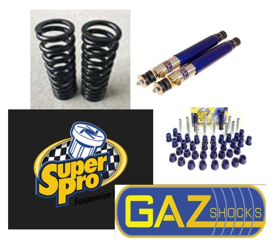

    Does anyone know why Gaz make different ride height shocks for the Stag?
    TRANSFORM YOUR STAG'S HANDLING The Stag was on the drawing board in the 1960's, over 40 years ago! It has been said by some purists that it was, and still is, perfect. Which is great as every iconic car needs its curators to preserve it. However If you like to drive your Stag on modern roads Monarch have developed a ho
    I imagine that they have reduced travel to suit the shorter springs. If you fitted normal ones, the springs would flap about every time you jacked the front of the car up.
      Think its a fallout of something that I did about six years ago. When I converted the car to air springs, I got GAZ to make me some custom front and rear shock absorbers to suit the new ride height and the air springs. Well it's a good to have them on the rears it's not so much on the front. Due to the fact that the front are lot under tension which could cause the very fine threads that hold the insert into the upright could be damaged due to the fact that the piston rod will be a lot shorter. Well thats what i found.
      Would have been good though if Monarch could have actually put the correct photographs for their products, its always down to that little attention to detail.
