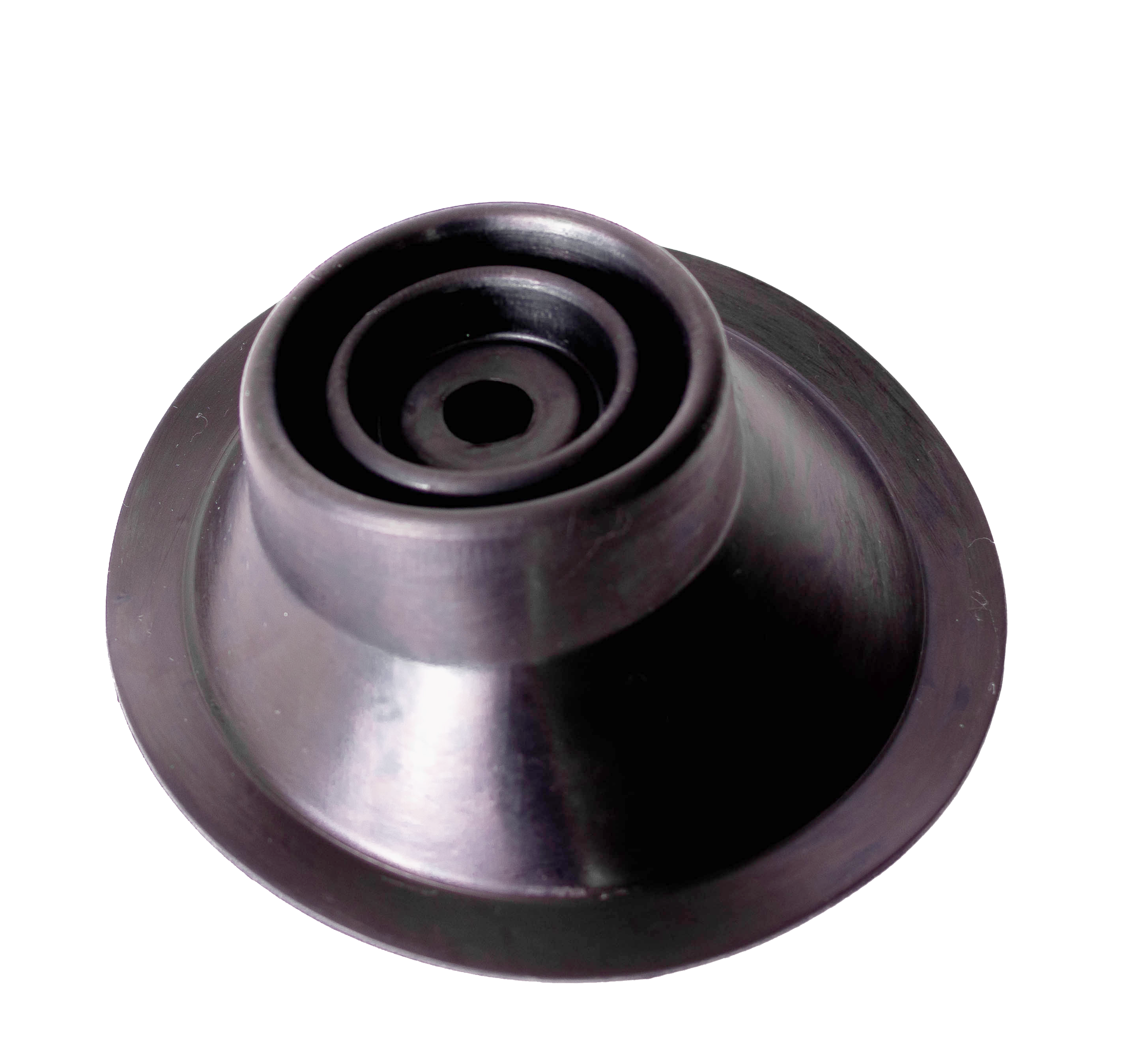

        Sounds like the rubber gaiter has gone as Neil has said. That sits under the wooden panel and it is responsible for stopping the hot air in the transmission tunnel being sucked up into the cabin. It is quite common for them to split. Mine certainly has!

              Do yourself a favour and forget anything new in the rubber gaiter department, they just do not last. Mine has a piece of leather screwed in place and seems to be flexible enough to work.

                Both of these companies have a good reputation for selling quality rubber items:
                Product Code: T/GAITER04High quality aftermarket reproduction part OEM Part Number 715382 Vehicle Part Category Engine Components Material EPDM Colour Black Max Continuous Length Weight 0.053 kg
